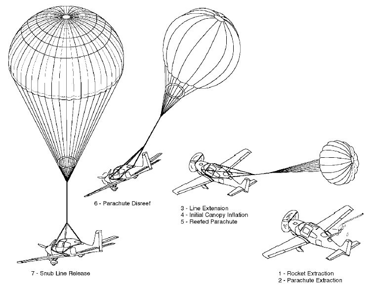

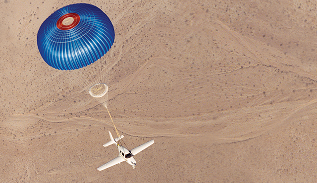

The rocket ensures that the parachute will deploy successfully despite the attitude of the airframe in flight, such as a spin or while inverted. The parachute inflates slowly and the risers are reefed to ensure a rapid transition to stable attitude under canopy.
Tests demonstrate that within 8 seconds all forward velocity is reduced to zero (relative to wind) and descent occurs at about 1700 fpm or 17 knots or 20 mph. The parachute deployment airspeed was demonstrated at Vpd of 133 knots. The demonstrated loss of altitude was 400 feet from level flight and 920 feet from initiation of a 1-1/2 turn spin. Four CAPS deployments occurred successfully at higher speeds, 168, 171, 187 and 190 knots indicated airspeed, and one deployment failed at an airspeed estimated at over 300 knots airspeed.
